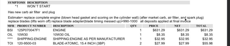

Hi everyone - the shop got their estimate back and they said that the engine has a blown head gasket and scoring on the cylinder walls. $950 to replace the engine! Feels wasteful to spend that on the fix - any advice appreciated! Thinking the economically viable options would be to either fix head gasket/replace engine myself or scrap it and find something else.

$950 is ridiculous for a push mower engine. Around here, you can find mowers w/ a Briggs 12xxxx engine for $20-$60 that just need a carb cleaning/rebuild or a new carb. I like those engines - have them on multiple mowers.

Thank you - my thoughts as well when I got the estimate back! I don't fault the shop as I think they only use OEM products and this engine is a bit of an outlier I imagine. To your comment, would any Briggs 12xxxx engine bolt in here or are there specific specs I need to look for? Never done an engine swap before but it doesn't seem overly complicated so could be a fun winter project. Thank you!

Most (maybe all) Briggs 12 mower engines will bolt to your deck w/ 3 bolts. The differences will be Autochoke vs primer bulb & others. Some older engines will have a throttle cable to the handle (avoid). Study your IPL 121S02-0130-F1 and compare to potential swap IPLs. I have 126M05, 126T02, 128M05 on mowers.
