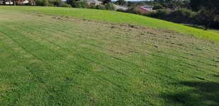

I currently experiencing experiencing tracks being left between blades. Running a 48in 7 iron jd deck with 3 blades. The blade cut is fine and even but I'm getting 2 tracks left between the outter and inner blades, running out of ideas where to look. Yep, tire pressure is correct and the deck settings correct.
Any suggestions welcome.

7394 thanks for the reply. No its clean underneith an if I reduced my speed any further i be in reverse.tried attaching a pic but it keeps vanishing

As for the tracks are these wheel or gauge wheel tracks? Or are they narrower like the blade tip not cutting? Two different problems.
The first ones can be caused by the type grass being and its length. Here I have crabgrass [I hate it btw] and the direction of cut causes problems with left side of the deck and wheels pressing it down. The last one can be cause by dull blades, worn out blades, or blades shorter than needed to cut an overlap.

The tracks are left between the blades. All specs are correct and checked again every 2 has but not change. The deck is level as per john deere instructions, I've tried the anti scalp wheels both clear of the ground and on the ground no difference, in fact off the ground causes an other problem in thick grass by tilting the deck. My cut height is generally at an 1.75in2022-05-26-13-55-59-232.jpg
