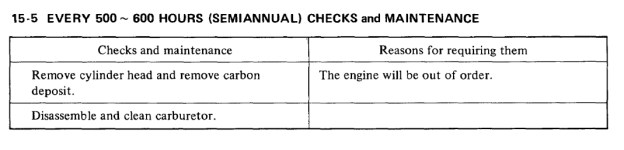

Not for nothing. I looked at 3 of my push mower engine manuals. One a Briggs, one a Kawasaki and the other the gutless Honda GXV160. They all say at X amount of time, clean the combustion chamber....
Briggs manual
Kawasaki manual
Honda GXV-160 engine manual

Here's a Kohler engine manual I just grabbed off the internet. Every 100 hours have the combustion chamber decarbonized.

This is from my king shiz nit Wisconsin Robin EY20V or WI-185 engine manual.

Chunks of carbon can break away, get into the bore, piston and ring area and gouge the crap out of these mostly aluminum bores. Yes some are cast iron lined. When that happens we get deep scratches which lead to oil burning. No secret where this leads.
Guess I'm the only one that buys/has old push mowers. Every one I've pulled the head on has plenty of carbon to make a sandwich out of. Huge chunks on the backside of the valves......

I'm a home owner. I follow what's inside these engine manuals. Why? These people made these engines and know what and how to keep them alive.
Shop mechanics would never do this, I agree. Why? People want the cheapest repair possible and will not pay for something they've never heard about. Most people have been programmed with spark plug and air filter only in their brain. Anything past this and you guys get a ton of questions.
