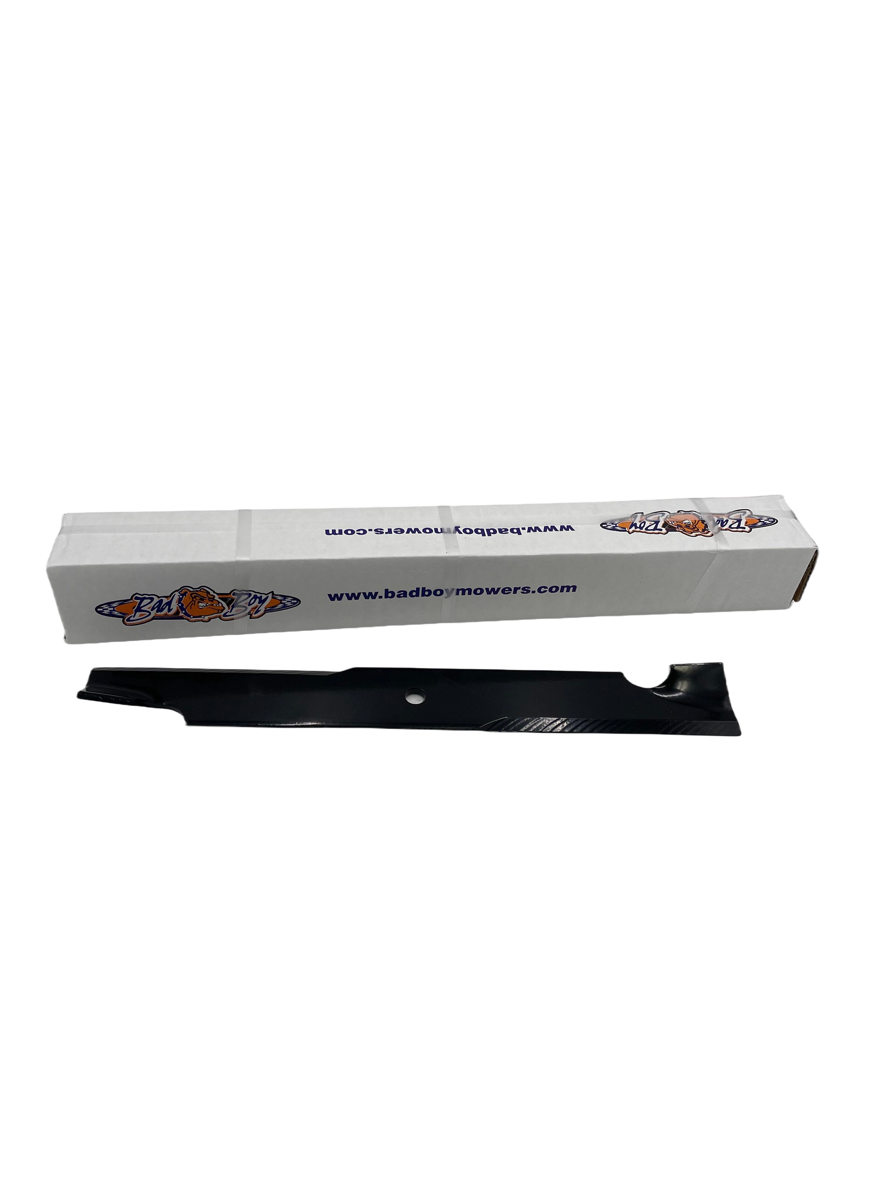

Well that would leave no overlap; unless, BB is lying about the cut width as 3 x 24" is exactly 72". I have yet to see a mower with no blade over lap.
Stihl does lie about the bar length on their saws so maybe BB is taking up the same habit.
actually I guess it's all dependent upon which Bad Boy dealer site one uses....
I just Googled this -
and it shows 24.218"
Hmmmmm..... :unsure:
121
12,895
That gives 24-7/32" or basically just over 3/32" overlap between the blades.
24.218" from blade tips to blade tips.

Bad Boy 72" deck use 24" blades...
