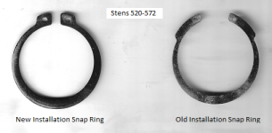

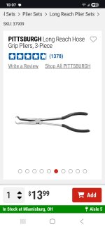

Heads up on this one as the installation snap ring is wrong. Does not fit even if you open the ends enough. I am lucky to have saved the snap ring from 15 yrs ago that works. See image for comparison. The ears are too wide and don't fit even on diamond of the square hole, plus can't open it enough without twisting. Complainant already filed with Stens.

The wrong one is coming in the amazon/ebay kits too.
I reported to stens about a belt for cub cadet being the wrong size. Sent pictures. Never heard anything back

time to take the old one with you to Ace Hardware. They have an excellent snap ring selection. McMaster Carr does too but you'll have to measure it with some calipers rather than match it.
Its not used as a tru arc ring. It's a tool for a kohler fuel pump.
