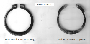

Heads up on this one as the installation snap ring is wrong. Does not fit even if you open the ends enough. I am lucky to have saved the snap ring from 15 yrs ago that works. See image for comparison. The ears are too wide and don't fit even on diamond of the square hole, plus can't open it enough without twisting. Complainant already filed with Stens.

The wrong one is coming in the amazon/ebay kits too.
I reported to stens about a belt for cub cadet being the wrong size. Sent pictures. Never heard anything back

time to take the old one with you to Ace Hardware. They have an excellent snap ring selection. McMaster Carr does too but you'll have to measure it with some calipers rather than match it.

Its not used as a tru arc ring. It's a tool for a kohler fuel pump.

But not for opening up the snap rings. It is that Stens has put the wrong snap ring in the kit. I have found the correct inverted internal snap ring at McMasters just have wait for my next order as I don't the snap ring right as the old reserved one worked.
Even with the snap ring pliers I have the external snap ring can only open so much before it pops off the tool.
Anyway the JD LT160 is back up and running for the customer.
But this thread was more to inform that Stens is currently including the wrong snap ring in the fuel pump kit so anyone that gets one may need the correct snap ring.
