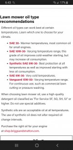

AFAIK SAE 30 mower oil is non detergent
All multi grade mower oils are detergent.

Oil comes in 2 varities
Detergent for use with a spin on filter & non detergent for use with a settleing tank
