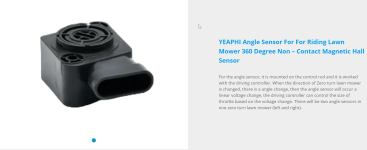

When I contacted PartsTree . com about the accelerator/transducer they responded 'these part numbers don't exist because they are only part of the entire harness and cannot be sold separately.'
The only thing I found online for it so far is maybe a supplier or clone of it from a company called "YEAPHI". Looks very similar, but only has the one photo.

Well that BS from Partstree as it being part of the harness when the 997144001 image clearly shows it on it. And do your leg work on the 997144001 as my distributor listing for a lot less retail.
And wiring harness doesn't show those sensors as part of it.
Now here is something you could do pull one of the control arm assembly and look for the OEM of sensor and their part number. A lot of the time it would be there. Then you could search for that part number.

Luckily I think my transducers are fine. I did snag a part number off the left control arm of TJ563A YP 201218(photo attached) for anyone trying to source one.
10,275
Available on alibaba. The problem is the info is in Russia.
