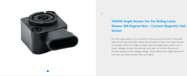

The Accelerator or Angle Transducer is located within the control arm assembly. (Photo of Homelite 997144001 Control Arm Assembly, Left)
When I contacted PartsTree . com about the accelerator/transducer they responded 'these part numbers don't exist because they are only part of the entire harness and cannot be sold separately.'
The only thing I found online for it so far is maybe a supplier or clone of it from a company called "YEAPHI". Looks very similar, but only has the one photo.

Luckily I think my transducers are fine. I did snag a part number off the left control arm of TJ563A YP 201218(photo attached) for anyone trying to source one.

Available on alibaba. The problem is the info is in Russia.
