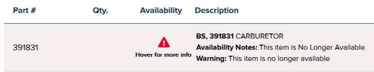

Good afternoon all. Newbie looking for help. I picked up a Wheel Horse GT2500 with an 11HP B & S engine. 252417-0245-01
I am in need of a replacement carb. Prefer not to go the Amazon cheap route. Can anyone steer me in the right direction?

You have to go after market if it is even available as Briggs has NLA it.

Thanks everyone for the help. I hit a dead end with Briggs and Stratton as well.
Will check for a mower repair shop in my area.
