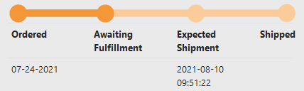

Still waiting on the parts i was told were in stock...6 days and not shipped, however compared to how long some of you on here have been waiting, I'll retain patience for awhile longer.

parts keep getting pushed back.... from 8/10 to 8/13 expected ship date... may call Parts Tree and see if they have the parts in stock.. then cancel this order and order them from parts tree... ?

Looks like the parts might ship out today.... the expected date was up to the 18th.
