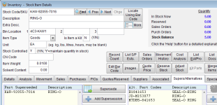

Well I never had crossed the o-ring until today to the JD part number as I usually go the Kawasaki PNs as I get them a lot cheaper from my kawasaki distributor and cut out the middle man JD.
But here is the cross. And update my system with the cross too.
This is how my system now has the crosses.

I haven't been to the Kawa dealer in many years because their prices usually were outrageous... So far I've had good luck with JD having most parts in stock They have this part in stock so I ordered and should be able to pickup on Monday 🤗
So your last screen shot shows the equivalent part number from JD, Kawa, MTD, and Briggs?
