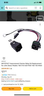

I had the same issue with 37hp vanguard. The fix was surprisingly easy after months of frustration This from amazion took care of it has not failed since. Took a few minutes to install.
Already had that installed 👍

I'm using a battery that came out of a UTV that I have. I replaced that battery because it didn't seem to have enough CCA's to start it. This battery is a 300 CCA one. I put it on a charger before I installed it, and after hooking up the starter assist relay, it started right up with just a touch of the key. Now it's taking at least 2 hits of the key to get it to spin over. The battery is showing 12.29v at rest, and after it's running for a few minutes, the charging system is showing at least 13.01v. Is this battery shot, as well?
