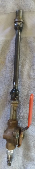

again thank you, guys! Here is a pic of my homemade leak tester, Maybe someone can make one for themselves.

Make sure you are at TDC or another place where the valves are purposely closed doing a leak down. Just saying....... Like valve adjustments checks and being on TDC. There are 2 TDC strokes in a 4 smoke engine.
