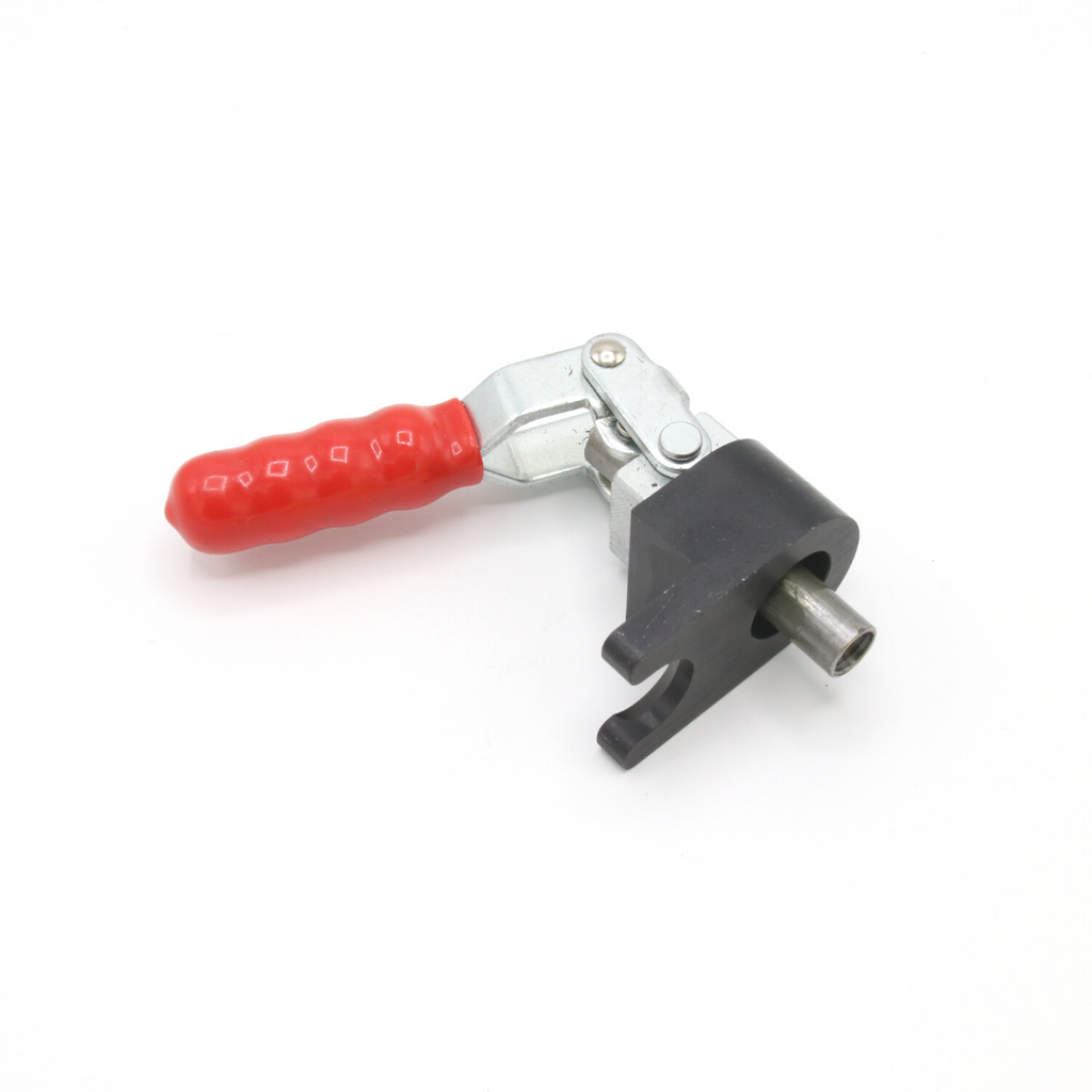

I don't have personal experience but this looks like an interesting tool used in karting. There are photos of it in use on the page so you can compare it to your head and how it works. Without seeing your heads from all sides it is hard to tell you what would work. Sometimes the angles and way heads are built it takes special designs to fit around things.
or maybe this one made by Lisle For springs 3/4 inches to 1-1/16 inches . Measure the diameter of your valve retainers.
