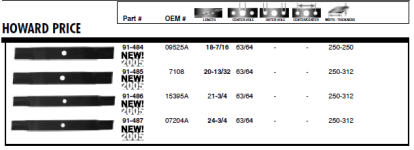

Good point. I didn't catch that. Is the notches in my blade important? Just as long as I get ones with the tips bent up (high lift)? I've measured all three and the center hole is 0.982" Is that considered 15/16" (0.934") or 1"?

I remeasured all three blades in case I was measuring a damaged one and all three are 20-1/2" long. Actually 1/16" shy (wear?). They are 2-1/2" wide and 1/4" thick. The hole AND the spindle measure 0.982" with a micrometer.
I'm considering buying a 0.204" thick blade in that length with a 15/16" (0.938") hole. I could open up the hole on each blade by running a conical stone in a drill from each side of the blade until it fits the arbor.
Is blade thickness that imortant? Should I stick with 1/4"?
If you bothered to check that chart then you would have seen 15/16" is a std blade hole size
Blade thickness is not important for fit

.982 is 63/64" which why you need a 1" hole. Oregon once made these blade but they longer do. Heck it has been 17 yrs since they were listed in their 2005 catalog. Back then they were a new addition.

What does the spindle shaft mike to?
It measures 0.982 also. Turns out my cheap micrometer is off a little.
Went to the local farm store and took my deck with me. Tried installing a 15/16" CH over the threaded spindle. Did not go on. I definitely have a 1" CH.
