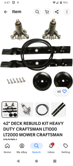

This is an okay method also but for most of these residential grade riding mowers, the bearings individually will cost you more than just buying the commonly available spindle assembly on eBay or amazon..
I just did a quick search in it does irritate me greatly that they're going for about 32 to $38 for a two pack because I was getting them for 18 to 24.
However there are rebuild kits available that's called a deck rebuild kit that comes with blades and everything and this one came up for $26.

I keep looking and it keeps getting worse. I just checked Amazon of course I always tell people Amazon is a terrible place to buy lawn mower parts 90% of the time. This is because you can get a better price and almost always a better selection if you scroll down eBay but there are a couple of things out there Amazon will give you a two pack deal on cheaper but spindles are not one of them.
Silly me, being spoiled for over 20 years with cheap Chinese stuff coming in but at great prices, just doesn't want to have to pay 18 to $25 for one spindle assembly.
Even though back in 2010 the prices started at $49.99 at Lowe's for an MTD brand one and the local shops were charging 62 to 70 for some of them and I don't even want to think about what John Deere dealers were getting for some of theirs.
Regardless, I'm spoiled and I don't do change.
I have some still here wrapped in Saran wrap that came as a multi-pack unit that I purchased probably around 2015 to 2017 and I was getting two packs and three packs and these things were literally under $9 shipped to my door.
This is the way it should be!!
