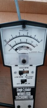

I use Standix Model 1082, just hold spring against wire & good to go! Don't foget rod adjusting tool.tach.jpgtach2.jpg

I've got the same one Steves has. 12 years, zero issues. I use it mainly on generators, but it comes in handy for lawn equipment if the RPM sounds a bit low. Those I can usually tune by ear.
