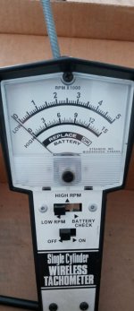

I've used this type for the last 40 years and servers me well...
Opinions will vary but I feel its about as accurate it gets. And works on any running motor and any given rpm...
Look around as I'm sure it can be bought cheaper.
No you don't have to be constantly changing the settings.
99% or better of small engines uses magnetos with wasted spark. Otherwords the plugs spark every revolution. 1 spark per RPM; be it two cycle or four cycle. Doesn't matter if they one plug or two plugs so inductive tachs are set to to one spark per rev. It only when you start getting into engines that use distributors when you start needing a different setup for measuring rpms. Even then it is usually one per two revs when it is a four cycle engine but that can be different depending where you are taching off the distributor which operates off the camshaft.
It like the old JD 420 here if tach off one of the plugs then use one setting but if you are tach off the coil lead then you use a different setting. When you do coil lead it fires the number cylinders per rev of the distributor. Otherwords the cylinder engine would be reading double on meter than the actual rpm or vica vesa. I never really got into that area with any of my tachs here.
As in shop RPM checks I have use Tiny Tach inductive meters but currently I using a Husqvarna/Echo tach to these tests. Note that I rarely check the rpm on anything other small engines.
Now if you plan to leave the tach on the engine then wrapping the pickup lead to one of the plugs is best.
