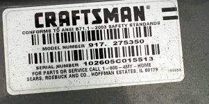

Loose belt issue. Craftsman lt1000 model: 917275350
