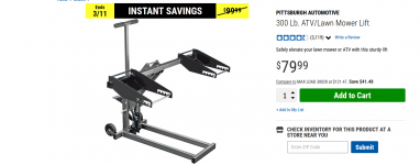

My 800mm lift floor jack does the job for what I need but at $80 it would sure make things easy for some folks.
I just use a floor jack, and i have some extra big jackstands, jack in the middle and a stand under each front axle/steering arm.
Pshhhhh. :ROFLMAO: :ROFLMAO: :ROFLMAO: 80 bucks! worth every penny until it crushes you.

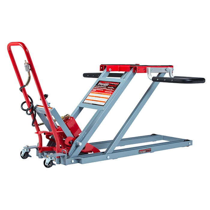

I have that HF lift and retired it. It won't lift big mowers plus it is not very sturdy. I spent good money for the lift i use now and it is worth every cent to me. It will lift 750 lbs. and is very sturdy and stable. I bet my life on it every time i get under a mower on it many times a week.
During mow season, I just use my floorjack & jackstands.. But during winter storage, I made 4 wheel dollys for it, that I put my z on. I can pull it out to do whatever on & later just push it back in it's place.
That's why I went with the bigger jack myself. The problem with the larger HF jack was the H saddle they welded on so I removed it. No problems raising the front ends of the 72" Hustler Super Z or the JD Z950M that work on. When comes more serious work I do use jack stands on the asphalt driveway. Currently having to get new 6 ton stands as HF recalled all of mine. Now I only got a couple pair of 3 ton stands.
I think my next lift style like the HF unit would need spring loaded wheels so the jack can be slide under things.
Years ago i was working on a small tractor and almost knocked it off jack stands while under it. I have a couple pair of stands but would rather use the lift if i am under something. I didn't have the rear brakes locked on the tractor so stupid on me. The lift helps with stupid.
