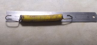

MAGGIEB Forum Newbie Joined Aug 20, 2023 Messages 1 Aug 20, 2023 #1 I found a painted yellow 4½ inch long spring on top of deck. The PTO spring is fine attached. Anyone know where this spring belongs? Attachments 20230820_185806.jpg 929.8 KB · Views: 6
JoeM(GA) Well-Known Member Joined Jul 10, 2011 Messages 195 Aug 21, 2023 #2 Kinda looks like the one at the bottom of the PTO lever #13?
S stihlmania Member Joined Dec 10, 2016 Messages 15 Sep 10, 2023 #3 I just looked at my 2007 LA120 42” deck. No painted springs. Two springs for PTO, 1 on deck for belt tension and 1 on PTO lever (which is the correct length.) Plus one much longer spring for drive belt idler.
B bertsmobile1 Lawn Royalty Joined Nov 29, 2014 Messages 24,995 Sep 10, 2023 #4 That looks like a parking brake or cruse control spring
S stihlmania Member Joined Dec 10, 2016 Messages 15 Sep 11, 2023 #5 Bert is correct, Parking brake does have a spring, hard to see but appears to be the same length but not painted. One end is not looped.
R Rivets Lawn Royalty Community Leader Joined Mar 11, 2012 Messages 16,285 Sep 11, 2023 #6 Looks like this arm tensioner spring. https://www.greenpartstore.com/John-Deere-Idler-Arm-Spring-GX10120.html
