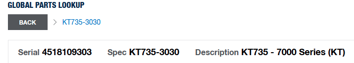

Scrub hit it on the head. Looking up your spec number the cam has no ACR.

Prime example why we always ask for the entire engine numbers. Part you wanted boiled down to the spec number, not model number.
PT did provide both sets of numbers including the serial number.
Results from dealer website.

Yes I agree he was. I was just showing what is available to us when we have all the numbers.
