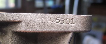

Walbro LMK12798 1205301 There are some other numbers that probably don't matter.
Not finding a LMK12798 or is that model "LMK" with a date after it? This Cub is listed as 1989 to 1991 on TractorData dot com
I bought this new in October 1990 - end of season sale. So maybe a typo on the carb date. 98 vs 89.
Gezze there are countless carb kids. Gravity feed. Would need carb-to-block gasket & carb-to-air-filter gasket, float bowl rim gasket, needle, seat.
The jet is slightly off center. Looks like it's pressed in. I'll just try to bend it back.
