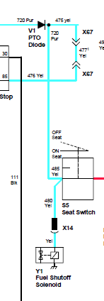

Here is a hint from the 777, 797 that uses the same delay module.
1. A delay module might be installed in place of wire 477 yellow. The
delay module prevents errant engine shut-off caused by the seat switch
being momentarily disengaged due to operating on very rough terrain.
if this is correct and the Z997 is using the wiring numbers then you can remove the delay module and install a test jumper to see if the module is the problem area. Just make sure you jump the right two wires. There will be 12v on one of the wires which what activates the module which in turn activates the magneto stop and keeps the fuel solenoid active during about a 2 sec delay. This circuit controls the magneto stop relay and the fuel solenoid on the 777, 797 mower.
But as I said I don't have the SM for the International version of the Z997 at hand. So this is just a guess.

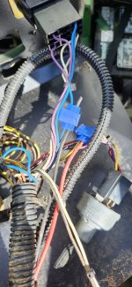

OK, the rain finally stopped and I got to dig a little deeper. I found a picture of a 2x2 pin configuration delay module that showed wire colors and I checked resistance reading that Kenbu posted on my 1x4 pin configuration delay module. They were very similar readings as shown in the attached pic so I don't think I have a bad delay module. More digging ensued.
Aha!, I found some more wire modification shenanigans put in place by a previous owner. Under the control panel, i found another jumper that picked up power off of one lead coming from to the ignition switch and fed it to a solenoid on the hydraulics pump. The other leg of the plug at the solenoid was jumpered to a wire on the PTO switch. Again, no idea why someone put this and the other jumper (delay module to fuel cutoff solenoid) in place. Not sure if the previous owner was a genius fixing a problem I haven't found yet or a hack just finding power/ground somewhere and using it willy-nilly to get something to work rather than fixing what was really wrong. Use of these blue piggyback splice connectors probably eliminates the genius probability.
I think I found the service manual on Ebay for this mower that should have schematics I can use to figure it out. I'll write the seller to confirm it covers my particular mower.
