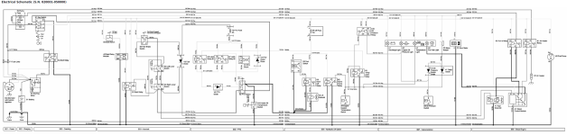

Partial seat switch circuit diagram. Boy I haven't seen a PNP transistor used in a long time.

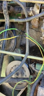

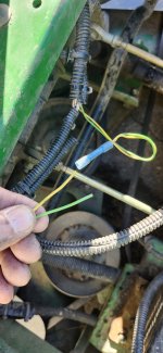

Remove the module and temporary jumper green wires 640 and 641 together. This will bypass the time delay module for test purposes.
