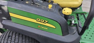

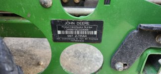

I'm working on a John Deere 997 Z-Trak for a friend and I'm trying to get the seat safety switch to work. I think it may be an early 2000's model (ID# DM997SC020068).

2006 Model (Serial No. DM997SC020001-030100)
IPL don't show an ECU instead a mess of relays so this is not a "R" series. Darn it. Have to contact JD for what is the correct service manual PN.
