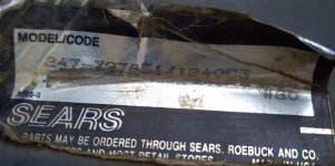

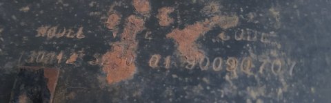

Alright, attached are pictures of the blower housing. I also included the model number of the chipper found at the bottom plate.
Any advise is greatly appreciated.

A bit hard to read but as it is 5 Hp, if that blower housing is the original one you have a 130000 series engine made in 1990 .
To me it looks like 130212 3250-01.
If that is right both the owners manual & parts manual can be downloaded from the Briggs web page .
The IPL shows a cam shaft mechanical governor which I will guess is broken resulting in the bolt in the throttle control work around .
Check this by finding the governor rod where it pokes out of the crankcase .
start the engine & hold onto the governor rod.
It should try to rotate as the engine speed goes up & down
If it does then get all of the missing linkages and hook it up
If it does not then you need a rethink as repairing it means a full engine strip .
Check the carb is the same as the IPL shows because he could have also fitted an incorrect carb which did not link up to the original governor easily
