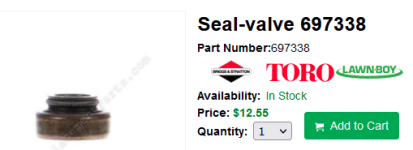

Yes I know that’s why I came on here. The exhaust valve doesn’t even have an oil seal. It’s only the intake valve stem that has it!

I’m not stupid I know what I am seeing when it is disassembled. But frustrating when the diagrams don’t match with what is actually inside. I’ve had both mowers pulled apart and they both identical inside. Only oil sea on the intake valve stem.

Not saying you are stupid. I can only go by the IPLs. As you said you are the one looking at it in person, Then you should install the new seal there.

I would but I don’t know how to get it out and then reinstall

Of course you have to remove the spring. But normally most seals of this type are just gently pried off the valve guide. They are just held on by fiction fit. But getting a sharp edge item in there can be a little hard. Also you could remove the valve and use a long pin punch that can be angled to catch the outside edge of the seal to drive it off.Something like a 1/8 pin punch since the guide is a 1/4 inch normally.
As for reinstalling it as you must use a bushing that fit over the seal edge and then clamp it back down on the guide. Something like a short socket might work along with a C clamp.

I was doing a full service and decided to clean the valves and head of carbon build up. I have damaged the intake valve stem oil seal. I have sourced a new seal but don’t know how to get old one out of install new one. Any help appreciated!

To answer the actual question though you should be able to use a screwdriver or something to get under the valve seal and tap on the handle of that perpendicularly to it to get the valves seal moving to remove it and then oil and slide the new one on.
That is standard practice because the inlet sucks so it drags oil into the engine so the resulting exhaust would not meet EPA specifications
Exhaust blows so leaks around the exhaust valve just increase the crankcase pressure that vents through the carb .
