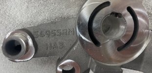

Casting numbers might help? Here is the new part.
Here is the original part. It's in a different spot too?
