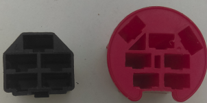

hey @StarTech I got those connectors but theyre too big to go far enough up in the harness?
IF you have either one of these housings then the F56 terminals will fit when properly crimped. Ignore the Red color as they usually come in black. It is just a reclaimed connector housing I got on hand.

it looks kinda like the red one but no matter how far I try to push it into the terminal hole it goes in maybe a 1/4 of the way?

this is the one I have

Oh **** it the latest style that I have so far not found any replacement terminals for. And it is royal pain to get the terminals out. Still working on it as JD is also using them as I just ran into this style a month ago here and I have not had the down time to do the research yet..
There is some good news however as you can the housing from Rotary under PN 12780 and using those F56 terminals completely rework the switch connector.
Sorry for the mis lead as I didn't know you had latest style. I was thinking you had the more common one.

would this also work? @StarTech
120
12,832
Yes.

Just noting those terminals are what appears to be Amp 42281-1 18-14 ga terminals. My distributor only sells them in cut strips of 100 pieces or in a reel of 24000 - 55000 pieces.
So I need to a strip for breaking down into loose terminals for later use here.

and that housing you showed me from rotary will fit into this ignition switch?
