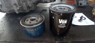

Well ... I bought another automotive filter with the same thread as the previous one (M20), only a little bigger.
This decision was not to further spoil what was started by the previous owner.

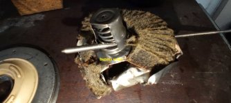

I also opened the old filter to analyze more filings and get to know it from the inside.

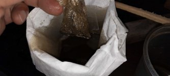

I washed it with gasoline to loosen the oil and filings, then I filtered the coffee (rs) and captured the filings with the magnet.
I certainly didn't capture everything and I don't know if it's too much or too little.

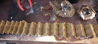

In the oil filter element, not everything that shone was made of iron.

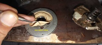

I discovered the two internal valves ...

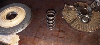

One thing that worries me is the bypass valve spring ... it is very strong and depending on the pressure of the pump, it will not open in the event of a clog and the internal irrigation of the engine can be impaired. In cars around here, the oil pressure ranges from 20 to 70 PSI, depending on the engine, I don't know what my B&S pressure is ... would anyone know?

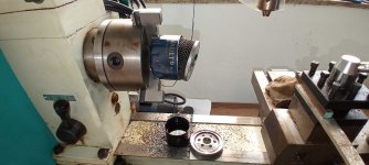

As some already know, I am repairing a Murray 42" with B&S 31P777 and one of the problems is the oil plug that came with a water valve (don't laugh).
I need to know the measures of such a plug to make an appropriate one, because here it is either very expensive or it is very difficult to get original parts.
I need the following measures:
What is the external measure of the plug thread?
How many threads per inch? I believe it is 20 ... is that correct?
Wrong valve...?

I live a little far from the big lawn mower market (USA), where everything that is imported is very expensive or difficult to find. Things that are simple and even cheap for Americans, are complicated and expensive for Brazilians, leaving us with the creativity for various solutions.
The problem (plug) has already been solved, leaving two questions:
1 - What is the pressure of the B&S 31P777 oil pump?
2 - How and where to place a magnetic trap to capture iron filings?
These are important questions for me, but they do not prevent the machine from working and can wait a longer time.
I saw an adapter on Amazon (Briggs & Stratton 492061 Remote Oil Filter Adapter), which can solve both issues and a third one, which is the clean filter change ... but the price to get my hands more than doubles and the solution is also to make one, and this is not difficult for me.
sheenist
Jun 9, 2020
25
Bange:A simple way to determine the size and threads per inch is to find or create a piece of round wood that is slightly tapered to start in the threaded hole. Screw into the threaded hole abaou a 1/2" then remove. The marks left on the wood will tell you the correct number of threads per inch. It will also tell you the minor dia. of the thread. I have seen this done with a small limb from a tree that had the bark removed with a pocket knife. It takes longer to read this than to do it. Good luck.
