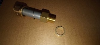

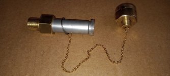

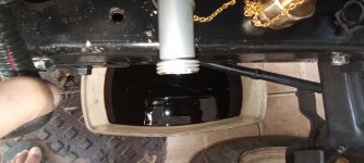

Turned and ready parts.
Connected parts.
Note: soft washer is missing and exchange EVA rubber for another nitrile.

I don't mean to sound condescending but i think you're over thinking it some....go to your hardware store. Buy a 3/8 NPT tube, male thread on both ends and buy a cap or valve to fit on one end.
Teflonsealing tape on both ends. Install it. You're done.
Or you can call Briggs And Stratton and ask them what size thread the 31p777 engine sump drain plug is.
Perfect answer. Believe it.

I totally agree ... but when the option is too far away or too expensive, there are other possible and fully acceptable options ... not for everything, of course!

You know something is good, but can it improve?
So it is...

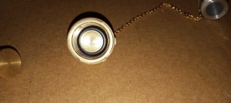

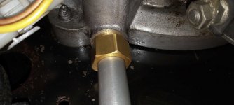

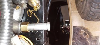

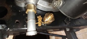

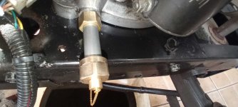

A small modification ...
Nitrile rubber is expensive and would still have to be adapted ... but there is an almost inexhaustible and free source on the floor of car workshops.
It is an O-ring of the fuel injector nozzles.
Then...
I tried to make an aluminum washer, it didn't look good ... so I made it out of brass too.
With a good grip I don't think it would leak, but I added teflon tape as a guarantee.
I am concerned with vibration ... as the lid will not need a tightening tool, only the hand, can it loosen and leak? It will be seen during the first hours of use ...

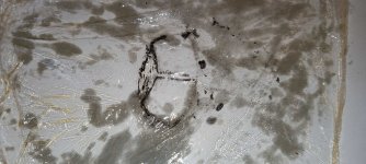

Analyzing the oil ...
Due to the lack of knowledge of a standard procedure (which can even be centrifuging and not magnetic), I adopted a very simple one that can be seen and understood by the photos and video below, remembering only that the oil was not at the working temperature and that the debris in greater volume and size must be retained in the oil filter.
This was the initial oil collection pot.
Attaching a magnet to the bottom of the pot
Iron filings ...
Wrapping the magnet in a PVC film and immersing it in the oil.
Iron particles captured by the magnet.

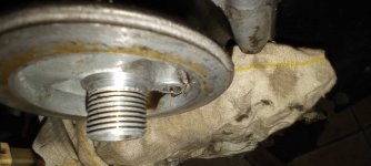

It was not in my plans to replace the oil filter now, however, after the presence of iron filings was confirmed, I decided to remove the oil from its interior ... and I found another problem ... the engine thread is 3/8 inch and the filter thread is 1.5mm, sacrificing the motor thread.
Well, the evaluation was preliminary and I do not consider it conclusive, but it only served to confirm the presence of iron filings, which certainly passed through the filter, if they are harmful in size or volume, I can say nothing, but logic tells me that it is.
I will think of a way to set a trap, but this will take a lot more time.
