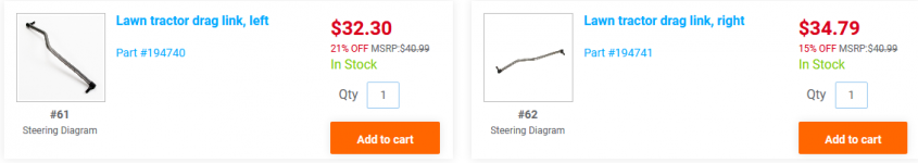

from what i see, appears that part isn't available by itself, just the entire draglink.

It's a tie rod end, but in many cases it is sold as part of the drag link all as one part. John Deere for instance makes you buy a complete new drag link with new tie rod ends wheather they're all broken, loose or not

Here is the part you need, called a drag link or steering arm.
You need the mower's model number off of the tag under/behind the seat to look up the correct one.

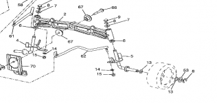

If this design has one on each side, I have two cautions. 1) replace both. 2) wheel toe in toe out may be fighting due to front axle mounting slop allowing the axle to tilt for and aft causing toe in toe out to change beyond normal in forward and reverse but in opposite widths of toe in. The strain on driving, steering, and wear will only get worse. I have not found a way to fix this at reasonable shop repair costs and have condemned no further cost effective repairs on two units.

Now that you have P/N's I would shop around for the links. For instance, Amazon lists a kit with both links for $47 with free shipping. That is pretty much what you pay for 1 side after shipping from Sears.
Great advice. I will replace both sides. I figure no matter if only one side went bad the other may be soon to follow. Now I need to find a write up on aligning them.
