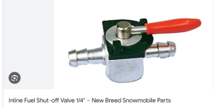

Inline fuel shutoff valve? Install and use it or if you don't have one get one.
