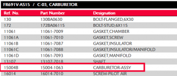

Now as for the carburetor PT it is a Walbro LMF-26-1.
About $120 with tax. That's not as bad as I thought it was going to be. I was just guessing a few days ago when I started looking this up, found one that was over $340. WOW!!!!!! The customer said the same thing. We just stood there saying wow, back and forth to each other.
Then came the awkward silence. :cool:
Buy the Ariens/Gravely part and you will pay $250.

Hate to do this but through my distributor that Walbro is only $45.42 but they don't it in stock. As for the 15004-1063 it is $269.57 and they have 7 of those in stock. So you know which they are pushing.

MParr that not the carburetor that the FR691V-AS15 is showing as to be used so jetting may be wrong.
I imagine that you’re right. There’s no telling how many times Kawasaki has updated that part since the engine in question was built. The AS15 suffix denotes the Kawasaki FR691 Ariens Service number. There’s a good chance that calling a Walbro parts dealer and giving the numbers off of the carburetor will get you a correct part cheaper.
