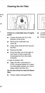

Curious. Does that include chainsaw air filters?
Applies to paper & fabric filters but not to plain foam because the latter already has big holes all the way through it which is why they get oiled to make the sides of the holes sticky.
When they clean paper filters commercially they use high volume low pressure pulses of compressed air to prevent puncturing the paper
Remember the warnings "do not blow directly onto bare skin" well this is why .
