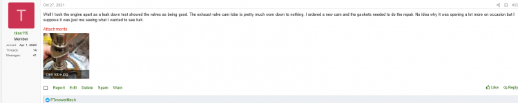

Well I took the engine apart as a leak down test showed the valves as being good. The exhaust valve cam lobe is pretty much worn down to nothing. I ordered a new cam and the gaskets needed to do the repair. No idea why it was opening a lot more on occasion but I suppose it was just me seeing what I wanted to see hah.

Dude, your cam is worn out. It's obvious from the video you posted of the valves working.
