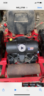

Thanks to all the helpful input in this thread, I found a new Kohler model that replaced the engine in my 20 year old mower perfectly. Pic below. Machine runs great now.
