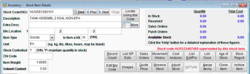

I have been on chat with Husqvarna and they said they don't sell the grommet separate and I should buy a new gas tank ($120). the part number they gave me for the gas tank is
The part number for the fuel tank is 532 40 74-89 and has a superseded part number 581290101.​
