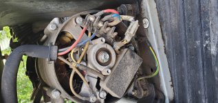

So I started it up and it basically just gets overloaded by the generator somehow. If I unplug what I think is the voltage regulator it runs fine. If I disconnect one of the wires at the brushes it will also run fine. Unbolting the 3 wires that go to the outlets doesn't get rid of the huge drag on the engine. So I don't think there is an issue with the outlets or control panel. Something in the generator side is apprently putting a huge load on the engine. Does anyone know how to troubleshoot this?
The black looking box is what I unplugged.

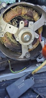

It looks like maybe the stator is burned or bad?
110
12,249
I would say it is bad when you see this.
and this
ILENGINE
May 6, 2010
11,230
@StarTech The had to be giving off an odor that would be unmistakable The burnt electric smell is probably still there if somebody puts their nose close to it. Looks like both the rotor and the field are cooked.
