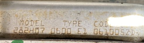

I am trying to help a friend get an old Bolens Lawn mower/tractor running. It would start then die,....seemed like a fuel supply issue. I removed the carb, its a Walbro 4993 with a Briggs and Stratton logo on it, also LMT and the number 77. I decided to clean it up with some brake clean and look for Identification on it and see if I could find a rebuild kit. Some numbers on the valve cover as well, See picture below.
Once I got it clean I removed the fuel bowl and found it had a fair amount of dirt or corrosion flakes in it. Also some of the internal bits looked a bit corroded, maybe water in the old gas? I looked up Walbro 4993 on Google and saw several Walbro LMT 5-4993 carbs for about $15 (new with shipping included) that appear to be the same visually,.....wondering if anyone can tell me if the 5-4993 will replace the older LMT 4993, or if this one can be saved.
Picture of the valve cover with engine numbers below,....the carb picture is too big to attach here but I was able to upload it to the "Photos" section listed at the top of the page. Album is called "Bolens Walbro Carb pics"

First the Walbro LMT 5-4993 casting number is just the base carburetor before being properly jetted for your engine.
Briggs 791888 is a gravity fed carburetor and has been superseded to 594593. Using this new part number you can find a cheap after market Walbro carburetor. Just beware that these after market carburetors are problematic. The OEM carburetor listed at $120. A good shop mechanic can re-jet the carburetor but that is something has to be done in the shop where they have the correct tools.
To me most DIYers are gamblers and will go for the lowest priced carburetor and then bitch like hell when the engine don't run right.
Just note that most times the original carburetor is repairable. But in your case there have been water sitting in the fuel bowl and the fuel solenoid is likely damaged too.
