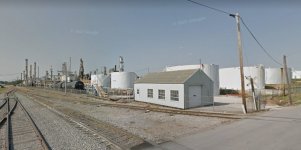

Friends of mine that actually make gasoline say winter gas is more likely to go bad over time than "summer blend" gasoline because it is more volatile to aid cold weather engine starting. 'Summer' gas will store better,BUT it's best to just NOT store any gasoline,just buy what you will be using soon. Run your OPE dry in the fall and buy fresh gas next spring. I'm only a half mile from an actual refinery .so my local gasoline is as fresh as it gets. I need to add, this refinery also supplies 100% gasoline-NO ethanol fuel added, to select stations in my area.
