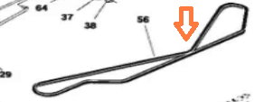

V-belt is a 1/2 x 82-5/8. They are fit very tight around the idlers on this model. Also this mower has constant pressure on the drive belt. I just did one this week where one of idlers bracket was bent
causing belt slippage.
Bracket item 47 was the one bent here and the idler nearly hitting the steering shaft.
It was locate along the belt as indicated by the arrow.
Also item 127 need be pull out and braced against item 142 as to pull to spring 128.
