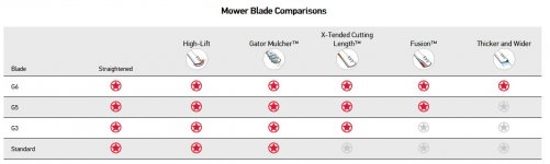

Is this the blade that you are talking about?
If so, those are Gator mulching blades and they do not develop the lift that standard high lifts do. On top of that, they will pack your deck with wet grass.
The Gator G6 is not primarily a mulching blade. It gets the 'mulching' attribute because of the serrations on the back side. But it is primarily a high lift blade. See attached feature list. Which is reflected in Bad Boy's renaming of it as "High Lift Fusion". In fact, I'm not entirely sure the Bad Boy OEM version of the blade has the serrations that the true Gator G6 has.
I've had G6 blades on my JD x758 for years. They don't really do much for mulching and they don't lead to deck buildup at all. I only clean the deck once a year in the fall when I have it off and am sharpening my blades just because it is habit, but it usually doesn't need it. I mow 7 acres a week.

Yes, Oregon does make Bad Boy blades. Now if the blade is 2.5” wide, it’s a G5. If it’s 3” wide, it’s a G6. My former Toro Timecutter HD 54 would take the 54” Bad Boy blades. I used both the Bad Boy high lift and the Had Boy Gator and I got much better performance out of the high lifts. When the Gators were toast, I never bought another set. With the Gators, the mower would puke big wads of grass all over the yard. I had much more blow out from the front of the mower. That didn’t happen with the notched high lifts. I highly doubt that I will waste my money buying a set for my new Gravely Pro Turn 160.

So, the stock blades are 2.5" wide. And they have a single notch in them, not the serrations of the true G6. Apparently whatever info I had seen that implied the stock Bad Boy 'High Lift Fusion' blades are Gator G6 was wrong. And they don't look like G5s either. These don't have the lifting surface of the G6 blades on my x758. So maybe a good set of true high lift blades will help me.

After looking at the Rotary blades, the stock blades look a lot like them. Very similar lift surface and notch.

Those are the standard notched high lift blades. Those are the ones that I would use. The Gator blades don’t have any more lift than the standard blades. When serrations are cut into the wing, you actually loose some lift. Like going down the road with your hand out the car window. Closed fingers and the wind goes around each side of your hand. Open fingers and the wind goes around each finger. Sunbelt XHT makes some super high lifts. I will try to find you the part number.
