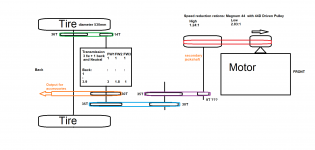

Hello I am from Slovakia, reach enough to buy new tractor :) I have one Zetor 6245 older but very effective tractor for farm. So my story is... My father already past away and I have an old small homemade tractor from him with broken motor from Jawa 500 OHC motorcycle. I am an IT guy and tell myself, I am quite good in hand working, practical enough and have some basic info around motors. Also as IT guy, I am learning fast and with combination of Internet ... it is enough to do something what will create little happiness in my life :) So yes, this is my hobby. Do something else than watching TV series as I am 8 hours daily in front of PC, I consider it is enough, and I am trying to do something different activity.
This motor cost me 750euro which might be something arround 800-900 dolars. This is half the price you can buy it in the shop. It is brand new, thats perfect. But I did a mistake and bought it without investigation... Tapered shaft ... static throttle, without muffler and without any informations for what those engines are supposed to work...
So I bought it and now I have it... and I am trying to do some miracles. I understand why there is governor, I am clever for this enough, at least I hope I am. In my first post I wrote this is last solution to do that as I know it can harm the motor itself.

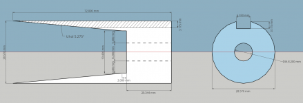

Purpose of small tractor: It is size of normal garden tractor and will do small work in our garden behind the house. You can see the picture of the forgotten tractor below :D as well as CVT white papers and my tapered adapter for the tapered shaft.

Hello, if you want to see how it did at "final" state, you can check it here on the link below. I have mounted a CVT just to to test if it reacts quite good on RPM motor has now.

- Motor will power transmission which is under the driver seat reached by chain links. Here is the picture of the chain links and ratios which I made just by hand. I still have to figure out the 2nd-ary jackshaft chain wheel. I suppose it have to be 9 teeth sprocket. However I am counting the ratios aaand it is still too fast for such tractor. Maybe you can help here as well.
