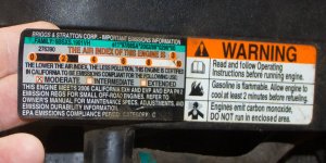

Take a deep breath, slow down and start from the top
What model engine do you have , numbers off the ID not the blower housing sticker.

Not sure which numbers you're referring to, but this is all I could find. It's on a sticker, so it's probably not the ones you are talking about.
As I've said, it just died after running about a minute. I may have run one split through it, but I don't think so. Just let it warm up. It happened many years ago. No loud noises or smoking, just died. Once it locked up, I tried to pull it once, but couldn't budge it. So I stopped. Contacted two local repairmen and both said it wasn't worth the cost to repair it. Buy a new one. The second guy had a used 6 HP pressure washer engine for $50, so I bought that and swapped them out. Set the locked up one on a shelf and forgot about it. A couple years later, when the replacement engine started to give me problems, I tried to pull the rope on the 'bad' engine, and it pulled freely. It now pulls like nothing ever happened. And I always checked to see if it had oil in it, so that wasn't the problem.
