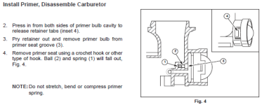

Thanks, I see it now (p/n 529). It's clean. But now the thing won't start at all, won't even try, like it's out of gas. The primer bulb doesn't have the same feel as I am used to - and shouldn't I see some gas in the carb after priming the engine?
118
12,664
Yes you should be able a squirt fuel everytime you press the primer into the carburetor throat.
There is a few things that can be the problem.
  1. 394 could be and usually the most common
  2. filter screen of 612 clogged
  3. filter screen 393 clogged (not always present)
  4. Primer check valve 913 may not be working. Note the primer bulb is a pain to get out at times so check the others first.

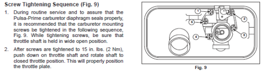

I have seen one or more of these cause problems. Also the plastic carburetor base can be warped from heat or over-tightening of the mounting screws. If warped then it is a new carburetor time.
