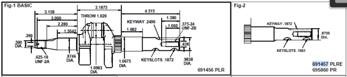

691457 Crankshaft PTO end specs
Thank you Star Tech for that helpful information. As I mentioned the fly wheel end of the housing is shot as is the crankshaft and conrod. But everything else looks in good condition. I may have a crack at picking up an old 190cc B&S engine without the PTO then, like Frankenstein, cobbling something together. I really liked this mower (Rover) and would like to keep it going if possible.
Hey Star Tech,
Given those diagrams and dimensions you posted am I correct in thinking that the basic upper crankshaft dimensions are consistent across these 190cc (6.5 hp) motors but there are variations in sizing and configuration when you exit the lower crankcase?
Thanks for any information,
Greer
