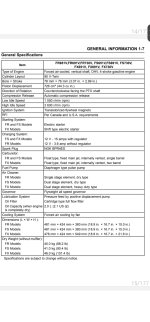

I have A Scag Liberty Z 48 with Kawasaki FR651V, and am wanting to get a cannister air filter from Power Equipment Man. They say no need to re-jet the carb or other modifications. What say the great minds on this forum?
The FR's are great engines. If you want a canister air filtration system. Go for it.
